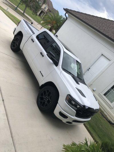

Very well, but the OP didn't say. He only stated he has a Laramie 1500 4x4 with the 3.92 rear end. Nothing about the picture of his truck tells me if it is DT or DS.
The picture of the OPs truck has 6 lug nuts, that's a DT body truck(DS only has 5). After 2019 there was just the Tradesman, Express and Warlock trims available in the DS body.
