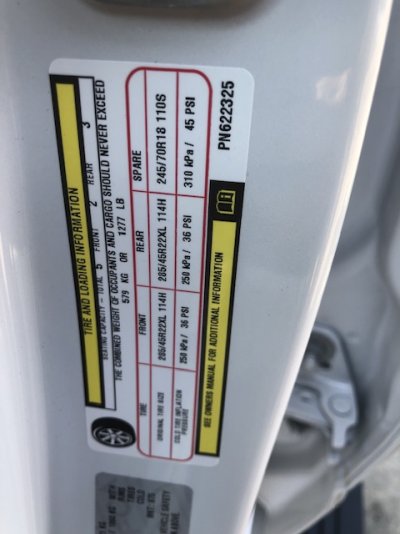

1277 lbs of payload is going to be the limiting factor for OP. I would definitely stick with a camper that is under 6500 lbs fully loaded. 12% is 780 lbs of tongue weight, leaves about 500 lbs for occupants, WDH and whatever else is in the truck.

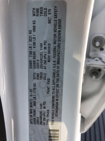

GVWR 7100
GAWR front 3900
GAWR rear 4100
GCWR 17000
The first 3 are in your door Sticker...the last one from the towing chart.

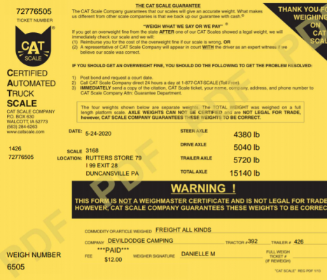

Load your family into the truck and head to a CAT Scale. Full tank of gas and get the numbers. This will be the minimum your truck will ever weigh. This gives you the allowable tongue weight for the camper...but, remember...anything else you put in the truck takes away and raises your base weight. Load as much as you can in the camper.
