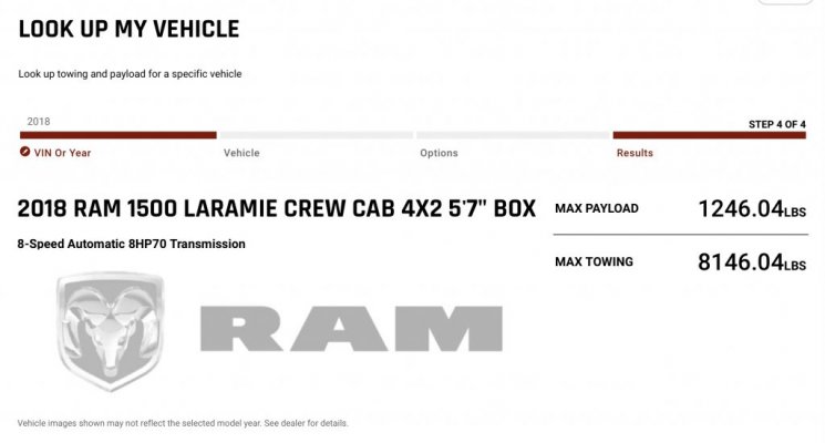

Put your vin in the ramtrucks website. That will give you towing and payload.
as everyone stated you will run out of payload fast in a 1500 limited.
