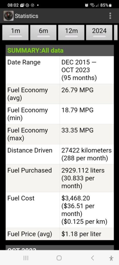

Funny, though..... they sure do gripe about fuel consumption!
Yeah, that's always kind of made me chuckle. Buy a Hemi, complain that you never get better than 15 MPG. Personally, I didn't see much change when I bought this truck compared to my 2000 Silverado 1500 4x4 that I had previously. At one point early on, I got 19 MPG on a 600 mile trip. By 2 years ago I was lucky if I saw 16 MPG. So, no real difference.
