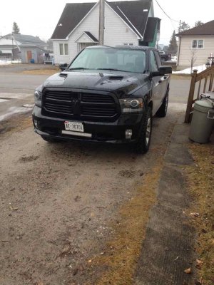

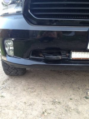

Worked very well, can kinda see them in this pick, the hooks sit low in the bumper cutout but still looks good to me

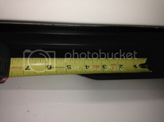

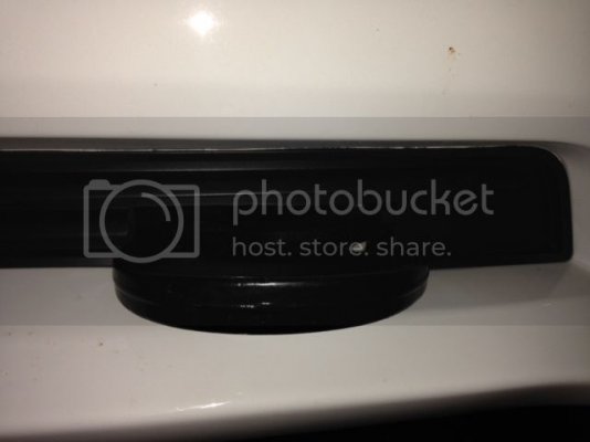

Any chance of getting one of you guys to measure the space between the hooks? I'm looking to buy a curved light bar for there. I'm curious if a 30" will fit.

30 wont fit i got a 20" in between them and about 2" to spare per side

Thanks for the info. I'm currently leaning towards a curved 20" which is about 22" in length so it should be a perfect fit.
