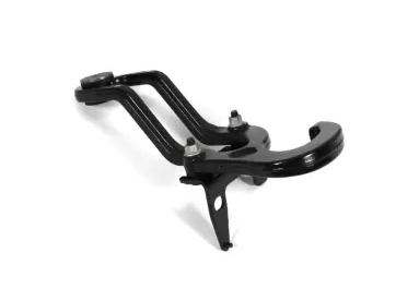

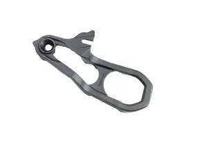

Basically, Ram produced two different versions of the 1500 from 2019 thru 2024. They continued producing the 4th gens (DS) and renamed them the Ram 1500 Classic. 2019 was the first year for the All New Ram 1500 (DT). It was totally redesigned from the ground up, which means not a lot of parts from 4th gens will just bolt on. The easiest way for a novice to tell them apart is the number of lug nuts. DS has five and DT has six.
For your question about the tow hooks, they are not interchangeable. You didn't say what model your truck is, only that it's a Night Edition. That is an option on more than one of the Ram 1500 models. Assuming you have a 5th gen (DT), you'll need tow hooks for a 2019 thru 2024 5th gen. See pics below:
4th gen tow hook
5th gen tow hook
