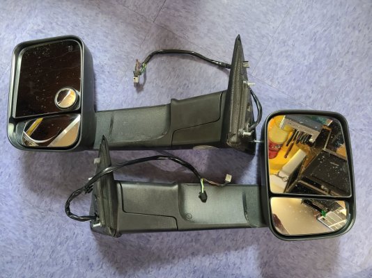

I have a pair of gently used black power folding towing mirrors for your 2009 - 2018 RAM and 2019 - 2023 Ram Classic and I think they fit 2500 and 3500 as well, but not positive. Shipping them might be expensive, but do you, or anybody else, live near central/northern California. Perhaps somebody can come pick them up. My 2013 Sport had them on when I purchased it in 2000 and the previous owner had the body colored standard mirrors included, so I swapped them out. They go on and off with 3 screws. Let me know.
Yes, they will fit 1500, 2500, and 3500. The mirrors are the same.
Ive been looking for a set for about a month but many of the aftermarkets kind of sketch me out with hit and miss reviews. i would be glad to pay for shipping.
