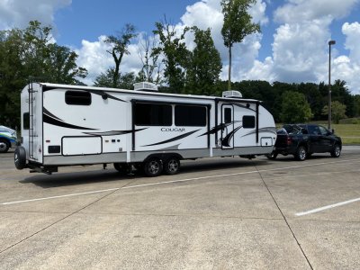

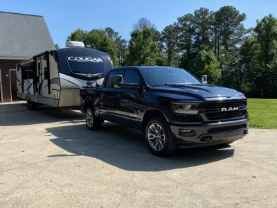

About 1 year ago I made the hard decision between a 2500 and a 1500. It was hard because I was trying to balance towing capability vs daily driving.
I purchased a 2019 1500 5.7 eTourque with a 3.92 rear end. I ordered the tow mirrors, air suspension, etc. We have since upgraded from a 27’ camper to a 37.5’ camper - a Keystone Cougar that weighs around 8K lbs.
Here is my question. Should I have purchased the 2500? When I tow the camper on normal roads I am fine. The 5.7L has plenty of horsepower and torque. Highway driving is downright scary anytime I get over 60 mph. Or any semi passes me. I have a weight distribution hitch that has anti sway. Should I have purchased the 2500? Would that help?

I would say the purchase of a 2500 for the newer longer trailer would be a yes. The 27ft. trailer would have been fine with the 1500, you have a giant sail behind you now that the 1500 just doesn't have enough truck there to handle.

That has a 8500 dry weight(1150 TW) with a 10.5K GVWR that can be a handful behind any pickup truck let alone when you make it 37.5' long. Can you tow this with a 1/2 ton(which this trailer line is marketed to), that depends on how well you pay attention to how the weight is load and distributed. A semi truck CAT scale will be your friend to check and adjust where the weigh is and how the WDH is adjusted. Where having a 2500/3500 truck is it will give more wiggle room on the set up, but incorrectly loaded that trailer it will still shove you around.

That is a nice trailer. And from the looks of the pictures, you look to have the WDH setup right.
Thanks. I appreciate your information on your experience. My wife though is saying it is her turn to get a new ride. I may have to find a used 2500 or 3500.
