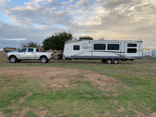

Too much trailer for sure. Being over payload is one thing, but that sail of a tail will wag the dog all day long.

I did the same thing you did. Smaller trailer with my 1500, upgraded trailer, had to upgrade truck. Your wife may not like it, but that’s the way it is, would you rather enjoy your trips and make it there and back safe or have that trailer shove you off the road and possibly something happen.
1500 5.7 Airbags and the 28’ trailer
2500 Hemi with 10k trailer
1500 5.7 with airbags heavy duty rear springs and the 35’ trailer. 10k
Buy a bigger truck for your safety and everyone else on the road. Wife will get over it.

You need either a 2500 or a 3500 (better) for a trailer that large, You will never get safe towing stability with a light weight truck, I have a 26 foot airstream which is right at the breaking point of the 1500/2500 dilemma - what we finally did was buy a 2500 and quite fighting the problem of a truck that had marginal capabilities for our trailer, you are way beyond solving any problems with a too light 1500 by adding airbags etc, its not a power issue but it is a size issue. Time to be safe and upgrade to a safer more capable tow vehicle .

If you need more ammo to convince your wife google trailer lenght and wheelbase. The 1500 will sway way more with a 38 ft bumper pull trailer.
Tim Giesin
Mar 20, 2020
Michigan
Looking at the picture it looks like you're trailer is low up front if this is correct this is your problem the truck and trailer has to be level
Engine size and axle ratio is your power regardless of 1500,2500,or 3500 your suspension and brakes is the difference

Several thing at play here. If you had a 27' trailer, you bought a truck that could handle it. Once you bought the truck you go out and buy a trailer way to big for your truck. Not much logic there. I tow a 26 ft trailer. I had the truck first, Ram 1500 Crew Laramie Eco-Diesel with GDE. I made sure the trailer Gross wt was under the tow capacity. If there is a warranty issue with truck and you are towing a trailer way over your gross warranty may not be good.
You should consider a bigger truck or a smaller trailer.

part of the reason the trailer sways is because the 2500 has 10 ply rated tires and the 1500 does not , the 10 ply gives you a stiffer sidewall and less sway.

I was towing a 33' Coleman 2855BH with my 2016 Ram 1500 with hemi and 3.21 gears. It did good on shorter, slower trips like back roads, but on the highway it was just too much. I had a BlueOx Swaypro, airbags, and e-rated tires on the truck.
This year I upgraded to a 2019 Ram 2500 with 6.4 and 3.73 gears. I towed that same camper on a 4,000 mile trip from New Hampshire to Badlands, SD and back. The truck can handle the weight without issue and there was plenty of power. While staying at the Badlands KOA I talked with a couple that run a Duramax with a 38' 5th wheel so we started talking about our trips (he is from CA). I explained that even with the sway control, it's still tough driving a bumper pull near the great lakes, through the White and Green Mountains in NH and VT. I asked if the 5W is really a difference and he said that is his first fifth wheel after coming from a travel trailer and the difference was night and day easier to tow a 5W.
Overall, I felt that the towing experience of trailers left quite a bit to be desired and my wife saw how much work it was to tow the travel trailer in the windy conditions. I didn't have issues with trucks passing, just the wind made the camper dance.
My wife was opposed to upgrading both the truck and then the camper at first but when I said I'm not doing anymore long trips, that sealed the deal because we like doing a destination trip every other year. We searched for months and chose our Cougar 30RLS. Like your trailer, it's "half-ton towable" and even says so on the front cap. Would I tow your trailer or my 5W with a half ton...NO. At a rest stop while fueling up a guy commented and asked if it is really half-ton towable and I told him honestly, no, it shouldn't be. Too much trailer for the truck and my 5W is only 34' long.
With that said, you have a phenomenal trailer, it's just going to be a bit of work to get everything set up. If I can offer one bit of advice; if you're looking for a used tow rig, and it's going to be a gas truck, the 8 speed is worth it behind the 6.4. If you want to future-proof, find a 3500 Cummins- the 2500 doesn't allow enough payload with a Cummins.
