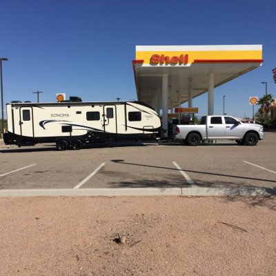

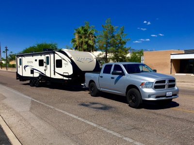

I bought my 2017 RAM 1500 Specifically for towing a 28 Ft Camper. It’s, a Long Horn with the Larime Package with all the bells and whisles.
It is a Hemi, with a 3.91 rearend, factory brake controller and 32 gal fuel.
I added Air Lift to the rear coil springs so the truck and trailer are level. This rig works out pretty well. When I get to a campsite and unhook, I still have a nice ride for going out to dinner or whatever.

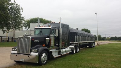

I own this truck...
This truck is licensed to gross 80,000 pounds, but if I pay the state a small fee...I can legally gross 96,000 pounds on the same setup.
Does the paper make the truck more capable?
A lot of this crap about GVW, GCW & GAWR is arbitrary and is suject to a lot of leeway out here in the real world.
