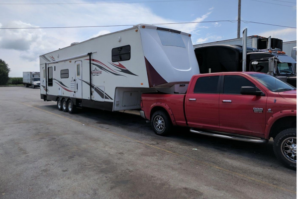

I generally try to stay within payload even if the truck can "technically" do it. A little different animal, but I once bought a 42' Toyhauler camper from an RV dealer in Bowling Green, KY sight unseen with the guarantee from the salesman that my 2500 would pull it with no problems. I mentioned my payload rating and he laughed. We were only 1,200 lbs over payload! No big deal with a Ram! So... against our better judgment we headed to KY to pick it up.
The trip home to Alabama was white knuckle to say the least. Power wise it pulled the rig just fine. Brakes were ok, but the drive was pretty horrible. It was windy and stormy coming home and at one point I was sure we were going to meet the ditch.
The dealership bought this one back the next day. I upgraded to a 3500 not long after that. Since that day I always spend a lot of time researching weights, etc.. to make absolutely sure I am within payload.
Our last camper was larger than this one and it pulled like a dream. Sizing the truck to the trailer (or vice versa) matters. If you need to modify the truck (aside from sway control) to handle the load safely, then you probably don't have enough truck. As they say... gotta pay to play. My 3500 spent more time as a daily driver than it did hooked to the camper, but it was well worth it. I could drive that rig with 2 fingers.
