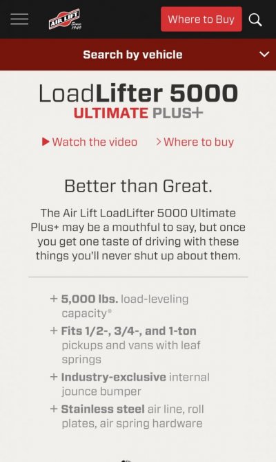

I tow a 7000 pound horse trailer with my 1500. No WDH. I added these and they’ve helped tremendously. Ride is smoother and I don’t blind oncoming traffic in the dark. I run them at 30-40 psi when towing and 5psi when not towing.
