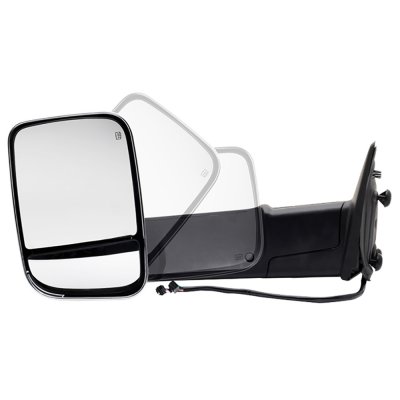

I will get the weight hitch....but I do not have the fold out mirrors my mirrors are power and heated only no lights in them can you point me in a direction on getting a set??

Air bags. Factory tow mirrors would probably be your best bet.

If you don't have the Factory Tow Mirrors you will have to get some sort of cheesy add ons, probably any RV service shop can order and install. Factory mirrors actually lift up enabling you to see to the sides of your trailer. If your brake controller is factory installed I would think you have the correct mirror. Hand on the bottom and lift up and out. 7k trailer is probably very close to your max.

It looks like you have the flip up tow mirrors for your truck in your avatar pic. They just rotate up.

Ok I have not tried to flip up the mirrors but my build sheet lists heated folding mirrors nothing about tow mirrors ...I do not think I have the tow mirrors....also sounds like air bags and bigger anti sway bar would be good investments

Depending on how much you plan on towing or if you don't want to change to the towing mirrors.
Fit System 80710 Snap-on Black Towing Mirror for Dodge RAM 1500/2500/3500 - Pair https://www.amazon.com/dp/B00AFV7DI6/

Tried to flip them...there not a flip up tow mirror

Well IMHO you'll need some sort of tow mirrors. Most campers are about 8 feet and change wide. Got me wondering if some states require tow mirrors as they do break away switch and chains over certain weights? You are talking a travel trailer and not a slide in camper correct?

Yes a tow behind.....yup looks like mirrors.....where do I get good mirrors and the air bags everyone is telling me about??

A1 Auto a vender on here can hook you up with mirrors.
