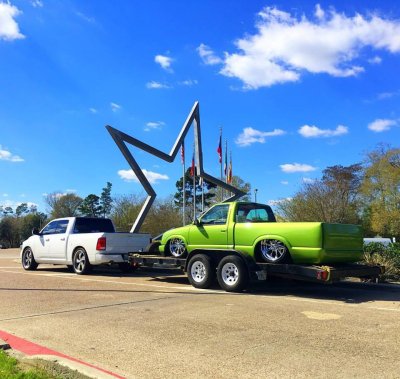

I have towed this truck and trailer to several shows with no issues.
My Ram is was lowered 3/5" with with the airlift durango bags in it.
but I suspect an enclosed trailer would weigh considerably more that this one.

between my two trucks towing the same rig, i feel like i can piece together a pretty confident statement.
cqsALtnmbBcsti6t30g7Z932OYosRMBByiuoAkDZhVTeFran4X77XSNU6bEWu6NW2rR7Kru9-TYzP7XQj-jPXwmBCi_y0QB69KI_APF888ARTL91JskDTGPuV7KL99_GjdVpHHHhm1-7nmZ3rs_hY7bCNTpdO5SZhE_16SaCyGeWYIFqc-k15aR-jSIk7QewrdNMhMebRjCMprJ_s6hpGoG1wGtzgSWIh1szv7xQGxpN2Gg1Oil9JufcWObNmAXD-OHqHMGgff1U2-zixMbkjj9zMxyfdc2ojS4uLt6NUl5YN2kcoBWQR6azecWNOCBgYg66txJ6hG1AHP8AwGQE-lkxeJj7yB1cRqEBiGYdvXqWlp7lyucA7yQnaIxQxjxQAmHJG0Vx_gRpsTQVKg31J-WHYVzXTl09UBkHv4W3XlVSdQqexwiHID6rTPKAF513KJNmLHcMhNLfoDq0_2zG0da5eDqbiBkjpYw-AW6YWGUWN7qesU0RWGQydW1sLBj7kO5UV8yZKVtFuyd0GdAhUSCYo-d6JEpPVQ715aJrs1yBkB1i8z0B6u3RcqsVODc1fJfgaJ3w-2_rwhVmSVOjjSH_oUrCj_Ydft6gnss-=w1904-h1428-no
i reverse leveled my 11 ram express, so it was *semi* lowered. i was fighting wheelbase in this scenario, wind does funny things to a rcsb truck with that much height and weight on the back. i dont have a pic of my current truck towing the same after i lowered it, but it feels much better. I feel like control arm relocation brackets would help me a lot now, but i don't have any complaints otherwise.
do the airlift 1000s if you don't want to cut your factory bumpstop cups. if you don't mind cutting a little bit, go with the timber grove bags. they seem to be a nicer kit than the airlift 5000 kit. the timber grove setup will give you a lot more wiggle room for leveling the vehicle than the 1000s, and much more air capacity too. You should be able to handle what you're trying to do though, i have a friend or two that tows with a rcsb r/t and don't seem to have any issues over stock ride height.
