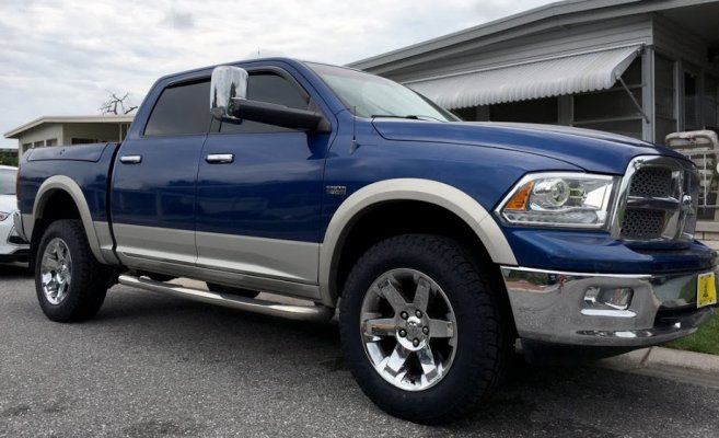

Got everything hitched up today to take the Airstream to get washed. Our 10 day count down till we leave for our full time adventure starts tomorrow. We'll be towing the Airstream from place to place, generally only staying at one place for one to two weeks at a time. So consistent towing for the next year.
I have Bilsteins 5100s, front and back, with the fronts set to 2.8 and out back I ditched the OE coils and Airlift 1000 bags for the TTC-1223 springs, 50% over OE capacity. Combined with Toyo Open Country AT/II's (275/65R20).
Unloaded the front sits at 39 1/2 inches and the rear at 43 1/2 inches.
Anyways, photos
The front came up to a full 40 inches and the rear dropped to 42 inches. Adjustments on the WD hitch aren't really making a dent, as the resulting problem, which you can see from the photos is, I need a new drop hitch. Forgot to take measurements afterwards, but believe I'm between 1 1/2 to a full 2 inches too high.
Thinking about getting this Reese drop hitch: Reese Weight Dist Shank - Drop Only - 14" Long - 4-3/4", 6-1/2" Drop - 1,500 lbs TW Reese Accessories and Parts RP63971
I'm pretty impressed with these springs and the ability to maintain rake on the vehicle
Over-all we drove around 20 test miles today, and I'm very happy with the suspension setup. And even the power seems unaffected by the heavier tires. I'm sure it is technically, but perception wise, was another story.
Just need to get that hitch dialed in and adjusted before we leave.
One more the Air Rig and Airstream together.

Looks good. If the front came up 1/2" inch and the rear dropped 1 1/2" how much rake does it have unloaded?

How many inches did the new coils raise the truck?
I believe the rear was 40 inches, so close to 3 1/2. They say they will raise the rear 2-4 inches in the product info.
Looks good it gave the truck a whole new stance nice and aggressive that's what I'm looking for! Love it! What are the tire rated E? How to the feel vs the factory tires?
The tires are E-Rated, they are 10-ply 34.10" overall height and 57lbs a piece unmounted.
Overall, when I installed the Bilsteins and had the Wranglers on before the coils went on, it rode just as smoothly as stock, but I feel it handled bumps better, and not nearly as harshly.
When the coils went, on the rear feels a little more firm. Some will say it rides more harshly, but I don't think so.
Combined with the tires now, the truck does feel more truck like, as opposed to stock. It rides firmer over some bumps but at the same time it's still smooth like a Ram going down the highway. Personal opinion here, I think keeping the same width and only going up an inch in size is a contributing factor in keeping close to stock feel. Overall it feels planted.
This much:
For reference, my truck before all suspension mods.

Truck sits pretty high...kinda looks higher than mine and i have thr same setup (except for tires). Almost looks like you have a 1 inch body lift, because mine doesnt look as tall as yours.
I didnt know upgrading coils would make that much of a difference expecially with all that weight in the back. How much weight total do you have (trailer +truck and people)?

So, originally up in the air
Got the new shank and started adjusting:
Level trailer and truck now.
Have towed her a total of 533 miles, from Florida, to Vogel State Park in Georgia. We are now 100% full-time living and working on the road with our two daughters. Moving from place to place. Towed beautifully.
