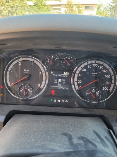

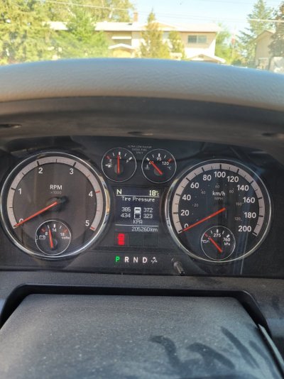

I have a 2011 Ram 3500, and was trying to get my TPIS system to work. Struggled with it for a while then it finally clicked. Anyone who has a Ram 10 - 12 should double check the wiring at the TPMS connector. Mine had the CAN+ and the CAN- backwards. Verify the pins before trying to program anything with AlfaODB. Long story short, it works........
Attached are the schematics and photos to prove that it works, as well as a link for the sensors.
