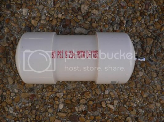

You can make a pipe "tank" using PVC and PVC caps with one of the sensors/valve stems hanging out and put 40 psi in it. I made one but had bad luck getting the sensors to program on my Maxima. I had one damaged and replaced with one off eBay with same P/N. You may have better luck with OEM sensors that are working correctly. Wrap sensors in bubble wrap to keep them from getting damaged, just don't plug the sensor ports.

Yea, that's an easy way to do it. Then just zip tie it up under your frame somelwrhere in the middle of the truck. I'm gonna give it a shot on the new 6.4, see what happens.

Just dont let that thing fall off. some one see that on the side of the road and you're going to see it all over the news hahaha

Yeah, I put black electrical tape over the dash light in the Maxima, an old Ford trick, lol. The pipe was in my trunk so no road carnage but a truck you can put it in the cab just make sure to use solid core PVC rated for 120psi etc. That composite core crap is only for gravity drains and might burst. Cross section looks like a green center on the weak stuff.
