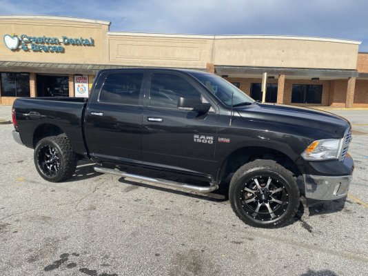

I have a 2018 ram bighorn. I just bought a set of aftermarket wheels and had my
Tires and factory tpms sensors put on the new wheels. 3 sensors are reading fine but my right front is blank like the sensor is dead. I’ve had the sensor tested and it’s working fine. My tire shop says I need to go to the dealership to have it reset. Anyone have this issue resolved without having to use the stealership?

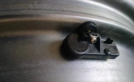

you can always try disconnecting the battery for 5 minutes. It is really hard to mess up the sensor. they are well protected and tough as nails.

Actually it is very easy to damage a sensor especially when removing them to put them on another set of wheels ....

Another thing that might be wrong is the battery on the sensor ... most TPMS sensors last between 3-5 years and you have to replace them anyways ...
If they used the same nut to secure it, didn't use the correct valve core can also damage the stem, you can't use the same nut to secure it.

I have done it about 100X's and no way to damage it removing it. they are held on by torx screw you remove the sensor from the stem and screw it back on to the new stem after the new stem is installed on the wheel. I guess if a tire shop screwed it up I would be pretty worried about their ability to mount a tire properly.

Then if you have done it 100xs you would know that the damage happens when they are mounting or dismounting the tires, the techs usually don't take into account where the sensor is and snag it with the sidewall of a tire or with the tire iron ...
And you can also damage the valve stem, so many ways to damage sensors .... by the way, I worked on Big O Tires for 4 years or a little longer and TPMS sensors are one of the things we replaced all the time due to other tire shops damaging them ...

I would say based on my experience and you have an 18, the sensor was damaged and will need to be replaced. A easy cheap test, would be to move the failed sensor to another wheel position, if the failure follows the location you have a bad sensor. You can do that my taking the wheel off and moving it, similar to a tire rotation
