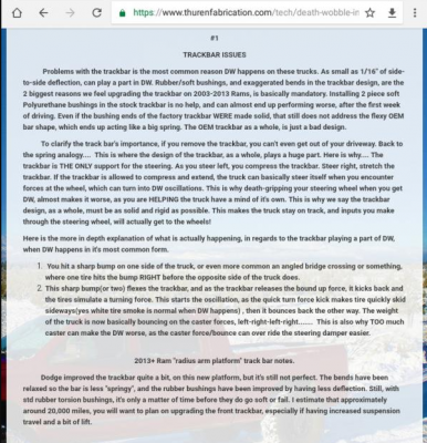

Can you get a bracket for the front TB?, sure, do you want one ? Don't know how the factory front TB is in the 2500's and how HD it is.Typically when you drop the TB you also have to do something with the draglink, i guess of some sort of pitman drop.. Both bars have a geometry in check and when you mess with it you can induce woobles in your steering. Do it right and get a more HD adjustable trackbar to start, the bar should be more than ok for a 2" front lift
https://www.synergymfg.com/synergy-13-ram-hd-adjustable-front-track-bar.html?category_id=5988
https://www.thurenfabrication.com/18mm-radius-arm-adjustable-track-bar.html

PW track bar is not more heavy duty then any other 2500, the only difference is it's about 1/8" longer because the power wagon has a slight lift from the factory over the standard 2500. Other then the length it is identical in design and materials
You said 3/16 in 2018 in ******* forums :) since we're counting fractions haha.
In any case the PW wagon should work for a 2" lift. I'll still get a Thuren or Synergy or Carli to center my axel and call it day. No harm and actually more strenght than stock. not a bad thing to have on a front live axle that it'll be lifted even 2". I don't skimp on the basics.
This was Don from Thuren, from the same thread where you posted the PW TB lenght
https://www.cumminsforum.com/threads/which-track-bar-carli-thuren-other.2398522/
