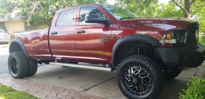

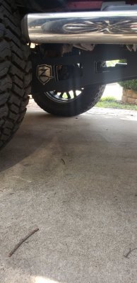

They are 22s on cheap 37s because I did not know better, about to get some 35" Nittos as it's time to start hauling the RV. That is the driving factor on the traction bars. Also just added a Fox Shock set up to help with ride..20200503_093949.jpg 20200519_173537.jpg 20200503_093949.jpg 20200519_173537.jpg
