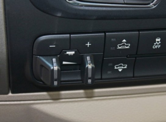

A '19 Classic is a Gen4 truck like your previous '14. The OEM trailer brake controller is just below the radio/HVAC controls closest to the driver, looks like this: OEMbrakecontroller.jpg
If you don't have the slider then the truck doesn't have the trailer brake controller. It can be added.

Thanks so much, Crash. We had to have one installed on our '14 as well. The one you're showing looks exactly like the one we had. I'll keep our appointment in that case. Appreciate the help.

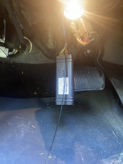

Heatheroo, here's one for you. First trip out. I'm most certain it should dangle from underneath and onto the brake pedal!

Oh........is that the entire OEM brake controller and it fell out of the dash mount? That's what $760 buys these days at the dealership? I would be livid.

That, my friend, only comes close to how we feel. Misquoted an estimate, charged $150/hour labor, then the friggin controller falls out?

be curious to hear the dealer explanation.....
