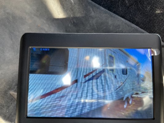

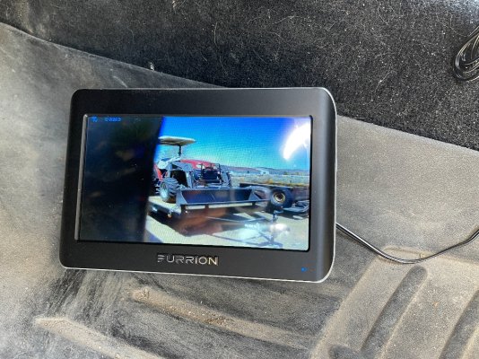

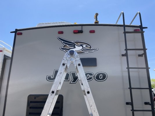

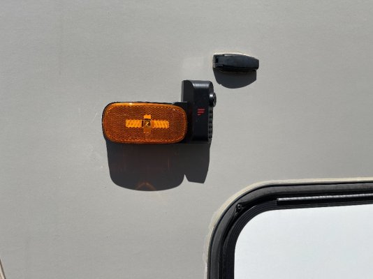

Today I installed the furrion 3 camera system with the 7” screen. When I pulled off the original marker lights I found green and white wires running to them. Normally white is power and green is ground. Not so in my trailer, it’s just the opposite. Apparently TT don’t follow the standard everyone else uses. That’s why I’m glad I checked the wires with a meter before hooking anything up.

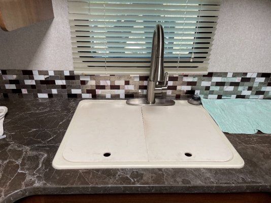

Of course I couldn’t stop with the cameras so I replaced the kitchen faucet too.
The new faucet is a residential, not a RV model. So I had to find an adapter to make it work.
Looks great, I wanted to do that too but there is very little access under my kitchen sink. No cabinet doors and only a few small drawers. I can't reach the fittings.

My back porch light had some weird wiring as well. My green was negative as well. black was hot.
