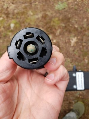

Thank you for your reply. The trailer does have electric brakes and what I think/thought is a 7 pin connection. I took a picture of it and attached it. This has 4 pins + 1 in the middle and 2 empty slots. Is this considered a 7 pin connection or a 4 pin?

Yeah. It is just a 4 pin. That is why you are not getting the mileage.
Our popup trailer is the same way.
Would be marker lights(running lights)then left turn then ground then right turn. The oe in the middle is reverse lights.
The 2 missing are trailer brakes and 12 v+ to charge battery

Thank you for explaining that! So - does this mean the trailer doesn't have electric brakes? The specs say that it has "brakes". I wonder if that's just referring to the emergency brake with the cable?

Here is how to know if U have electric brakes/system:
Do U have a battery on the trailer in the front, or just a "cable" to hook to truck? If U have a battery there in a case, you have electric brake system. No battery +++ no brakes ++++ trailer pin push/pull and all the stopping. If U have a brake system, U should have something like one of these (3) boxes on the frame in the front (usual place mounted). No box like this well no brake system.
THAT is a standard "4" pin setup in a 7 pin adapter. 4 pin lights only/no battery brakes
BATT box be in several locations: some examples below:
You have surge brakes. Look at the area behind where your ball goes.
You will see the mechanism
What happens is when you slow down the trailer pushes this forward activating the brakes.

Wow - all of you guys are AWESOME! Thank you all so much for explaining all this to me. I really appreciate it. I definitely do not have electric brakes. I haven't had any issues backing it into the water so I'm assuming that locking pin is in there. I will check it out in a little while. Again - thank you everyone - you guys rock!

The locking pin is probably a thing of the past. When the wheels sense you are going backwards they release. Same as with electric trailer brakes. When backing up they do not apply, as you are using your brakes while backing up.
As mentioned...you have brakes...just not electric brakes.
And you have a 7 pin plug that is only wired for 4...well i guess 5 in your case.
Does your boat trailer have reverse lights?
As @392DevilDog mentioned that locking pin surge brakes are old skool. Several years ago I rebuilt my boat trailer brakes, used what's called free backing brakes. Found out the factory put on two left side brakes, always wondered why it didn't track consistently with the truck. They good now and no problems.
If you wanted to track the mileage of the trailer, buy a trailer brake magnetic, 7pin plug
and wire the magnet to the trailer brake circuit.

Just went out to take a look at things...it literally says "Surge Actuator" on it and has a spot to fill the DOT-3. No question these are surge brakes - which up until today- I had never heard of. As 392DevilDog surmised, there is no locking pin. I think it functions exactly as you described. As for reverse lights - I don't think so. It has break lights and some lights around the tires and below the engine. Next time I take it out I'll inspect it a little more and see if anything lights up in reverse. Thanks again everyone - gotta learn somewhere - I appreciate all your help!
