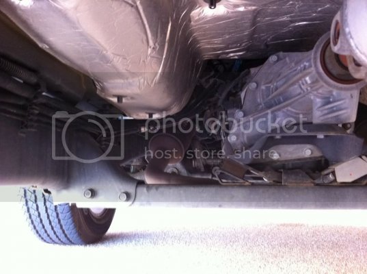

Would have to go take a look at that. Haha. The exhaust came with the truck, it starts as a true dual with two cats, but then the two pipes converge together into one muffler, and split off to a y pipe at the end. Kinda odd and was thinking about getting it changed. I'll take a picture under neath there and post it here as I have no idea what I'm doing still. Just know the few basics.

Would an air tank fit here?
