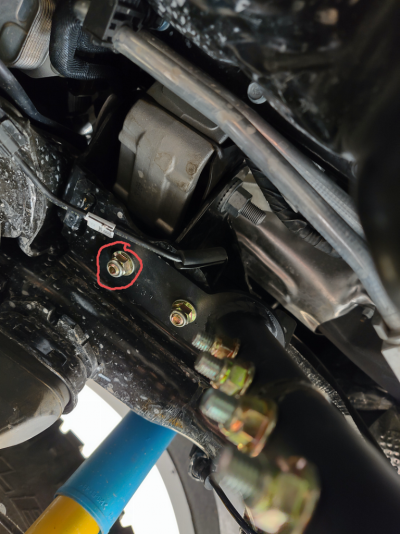

they mount on the motor mount brackets up front.
drivers side.
passenger side
retired
retired
Aug 19, 2020
2,172
2,792
montana
up front the circled bolts are the ones that were a pain. the driver's side bolt was tough simply because another hand would have been nice to hold the flag nut while inserting the bolt and holding up the skid all at the same time. the passenger's side was tough because you need a really stubby 15mm to hold it as a normal length wrench will not fit in the small space, if they would have used a flag nut for that location it would have made it much easier.
