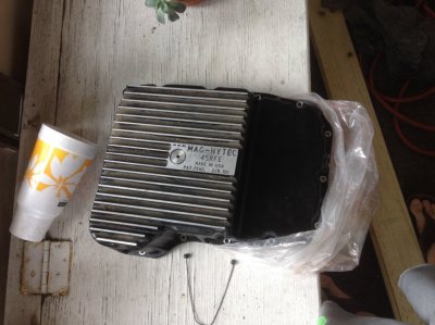

Got this done this past weekend. Had to find some stock converter bolts cause the circle-d used bigger ones. Didn't find that out til I had just the converter bolts, dust cover an crossmember to out back on :3681700201_eef6d1e2

The mag hytec pan looks big down there
