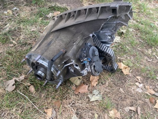

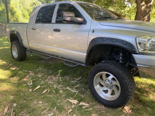

2006 mega cab not sure of lift bought it drove it home an the transfer case exploded. It was not in 4wd. It does have a large lift, an the case looks like it exploded where it meets the front driveshaft , the chain is actually still in tact so it cut everything in half at the cab, but has anyone else had this problem? I have a new transfer case and want to avoid destroying it… should I change the lift ? Or I can post some pix any help would be appreciated

Wow that certainly did grenade.....
Hard to tell from the pics, but the inside of that tcase looks pretty dry. Might have been low on fluid or had no fluid in it?
Any vibrations before it happened?

For sure have the driveshafts checked if they where not destroyed already tcases are cheap go to any junk yard or facebook.

I don’t have the front driveshaft my custom one is gone , factory length is to short
It might be a good idea to have someone who specializes in lifted trucks determine if the driveshaft angles are good before having a custom shaft made. You might need to alter how the transfer case sits, sometimes they are rotated downwards to lessen drive angles
