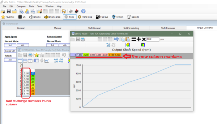

I have still yet to figure out why the TCC doesn't lock until 60 when It's in tow haul mode (3rd only OD off)
Bear_Gibson
Bear_Gibson
Feb 10, 2016
199
30
Cape Girardeau, MO
1999
5.9 magnum
Just in case anyone looks this up later. The reason the TCC timing was off is because the shop I paid to diagnose it modified the tcc table. I had to buy hp tuners to fix it, but it now locks in 3rd at 35. The Transgo reprogramming kit and upgraded direct (front) clutch pack are worth the hassle to me.
