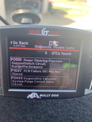

Just pulled DTC
The power steering thing and evap codes I know about....don’t care about evap codes as we don’t have emission
I have power steering switch have just been lazy about installing
