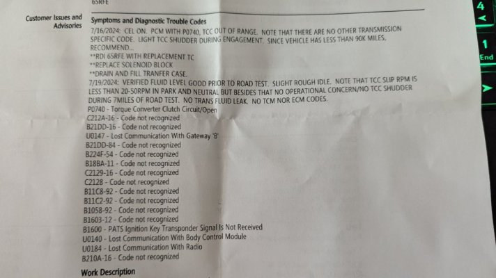

Here is a pic of the diagnostic notes from 7/16 and the final test notes from 7/19. I'm concerned about the line that reads, "NOTE THAT TCC SLIP RPM IS LESS THAN 20-50 RPM IN PARK AND NEUTRAL BUT BESIDES THAT NO OPERATIONAL CONCERN/NO TCC SHUDDER DURING 7 MILES OF ROAD TEST". Is a 20-50 rpm slip in park/neutral normal??
I'm taking it back tonight for them to look at tomorrow morning. What could the issue be? Why would I still have the p0740 code less than 50 miles after being repaired?? Thank you for your time!
