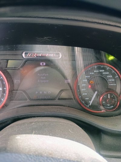

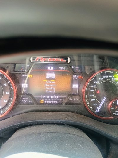

Whomever decided computers in a vehicle was a good idea needs to go flip burgers. I'm about 80 miles out of town and shut off my truck to load it up. Nothing funny happened. Go to start it back up and I get this. Also I can't power it down without disconnecting the battery. Tried unhooking the battery cables and hooking them together for 2 minutes and nothing changed. Any ideas? 2020 5.7

Tester says 12.6 volts. Battery replaced in December.

Got it to spit out more messages. Id trade this thing in a beat bat for a 3 pedal truck.
Do you have a scanner to read DTCs?
Have any other messages appeared on the EVIC?
This information is almost irrelevant without a battery load test.
This $20 toaster-style battery load tester from Harbour Freight will verify the ability of the battery to handle the necessary starting current.
And if there's a flaky cell that only misbehaves under load, the CCA results will fail.
The battery is often the first suspect in our rolling microcomputers.
