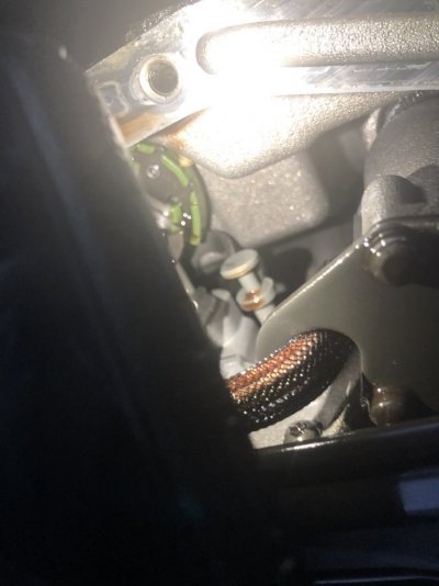

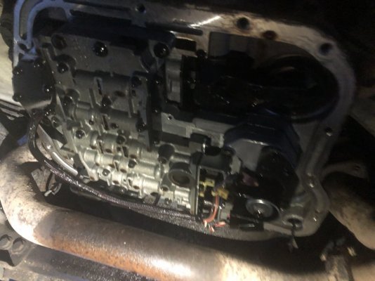

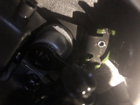

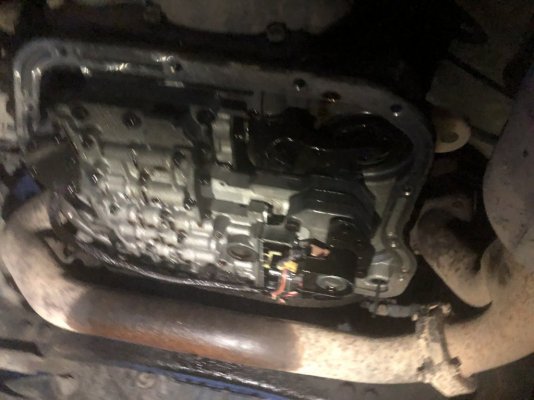

Ok , this is my first attempt at an auto trans repair, so I'm hoping I'll get some help! Got the truck back on the stands. While the fluid looked reasonably clean on the dipstick, after I started pulling the pan I found out otherwise. Pretty much looks like dirty motor oil, except more chocolate than Black. So far my efforts were somewhat comical as I didn't know what to expect while removing the pan. Anyway I managed to catch most of the fluid and got the pan and filter off without much hitch other than the fluid on the floor.
I took a bunch of pictures, maybe not clear enough, because it also doesnt go into park
I was using 2 phones one for light and the other for photo, so I might have to retake them, not sure if they are clear enough.

Ooops one pic too many, anyway most of these are the shift linkage area and the valve body. I cannot see anything obvious stopping it from shifting into park. Most of the pics are in nuetral or reverse !

I have posted about this issue a couple of times on some other threads. Did you remove the valve body to inspect the park pawl and the parking sprag?
If you are unable to get the trans to shift into park you will probably have to remove the valve body for inspection. Before you do that try these things...
Put the truck up on jack stands. Disconnect the shift linkage from the side of the trans. Operate the shift linkage by hand while spinning the driveshaft to see if you can feel the park pawl attempting to engage the sprag. If you cannot get it into park this way then valve body removal for inspection is imminent.
Now, for the shift flare. Have you done anything to the trans since you took the pics?
