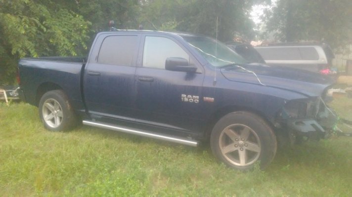

Well... Plans might have changed for the truck... How much do you think a 2015 dodge ram 4 Dr Hemi with a possible blown motor would go for? He is interested in selling because he got a new truck and wants to sell it to me ... But I need a price to throw at him before I spend time troubleshooting it... And HE told ME the motor is blown... So lets say the motor is trashed.... What would it be worth? And obviously I would like to have a Hemi to sit next to my Cummins and I can just expect to spend money on a new motor and hopefully it turns out to be something easy and I get a great deal on it! Soo... What do you think is a fair price for a clean 2015 Ram 1500 4 dr with a blown motor? (Grill and headlights were taken out to be able to use the tow-bar) Lol. Thanks for the help!0511220649.jpg
Look what the Kelly Blue Book states for a wholesale price at the condition of the vehicle and minus what a good long block or crate engine will cost to have installed. Google what that year/model truck goes for in the area and subtract for the motor replacement.
