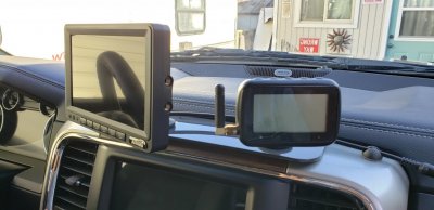

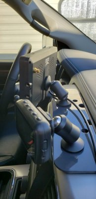

Razzman
Nov 27, 2017
743
659
Southern Arizona
2020 Limited CCSB
I prefer to have the monitor above as I like to use as an observation camera and still have the 8.4 screen available for my nav or whatever. My setup which is all magnetic, easy up and down.
