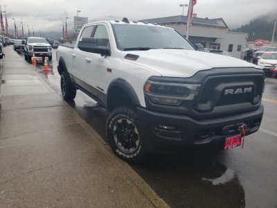

So I figured it was time to start a build thread. This is my 1st Ram and Power Wagon. I have mostly been a Toyota driver with a few GM products thrown in. I have a hard leaving my vehicles stock and really enjoy modifying them. I have a Four Wheel Hawk Camper on order and should be getting it in about 6 months.
I picked up the PW December 23rd from Dave Smith in Kellogg, ID. Drove up there and back in the same day.
Here is the items I have currently installed or waiting to be installed.

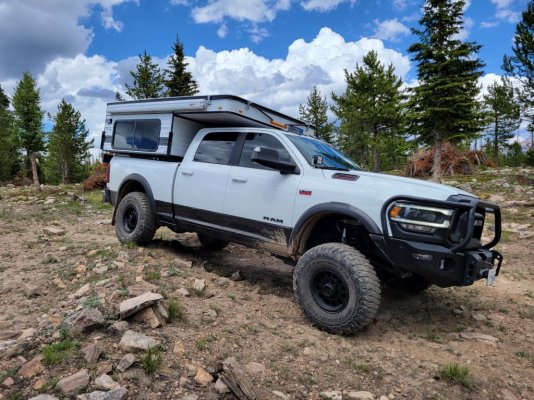

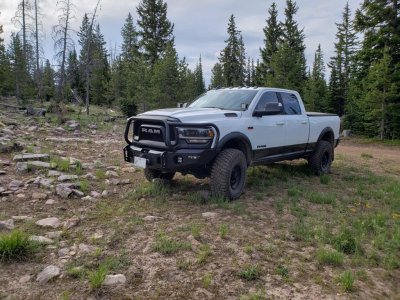

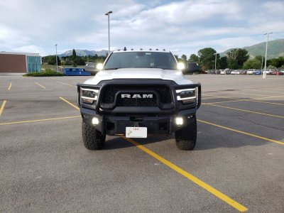

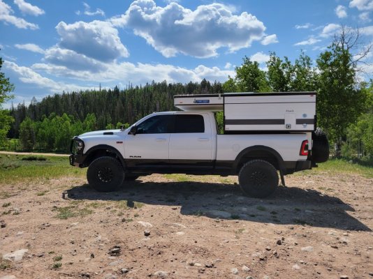

Here are a few pictures. Will work on getting some that are updated.
20191223_095200.jpg Truck Picture 2020.06.29 1.jpg Truck Picture 2020.06.29 4.jpg

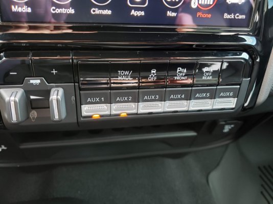

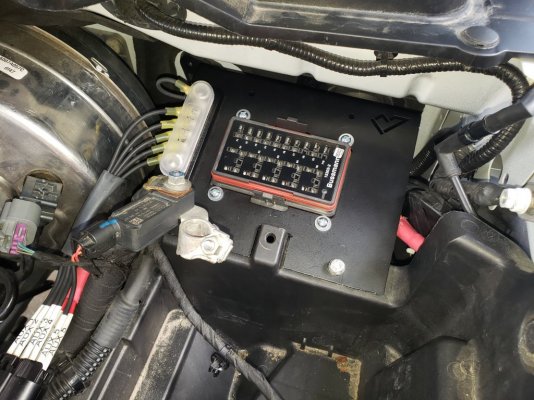

Here are a couple of pictures of the switch panel and fuse panel. The switches work just like OEM. I did have to work with Alfa OBD to get them turned on. I have some extra connectors to make a harness that plugs into the back of the switch panel if anybody is looking to add the switches. I have a diagram for the back of the switch panels if anybody needs it.
