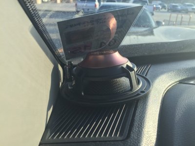

Troutspinner, will those 4.5" scans fit up in the dash? I was debating putting a l4v2 in there if I could get it to fit. Don't mind a lite trimming what do you guys think would the l3 or l4 be better? Want to compliment the l1v2 tweets in sail as well as l6v2 of n the doors. Any thoughts or preferences... As I am following in your footsteps. Still waitin on my box but movin down the line, I am right After lizard king.:3681700201_eef6d1e2
Here's an L4 compared to the dash location. A lotta choppin to get it in there

I decid d on the l3v2 for a better fit... I kinda new it wouldn't go but offered better freq ranges. I'll be happy the the l3

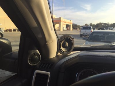

I even considered glassing a little enclosure in the corner and venting it into the stock dash speaker hole
another shot for size perspective

Thank you for that and $hit! The scans are 2mm larger. I think I have to re-think what I want to do. Damn! I thought they would fit. Argh!
100mm max is about what you can fit.

The 12M's come in at 115mm vs. the 118mm of the L4's.
