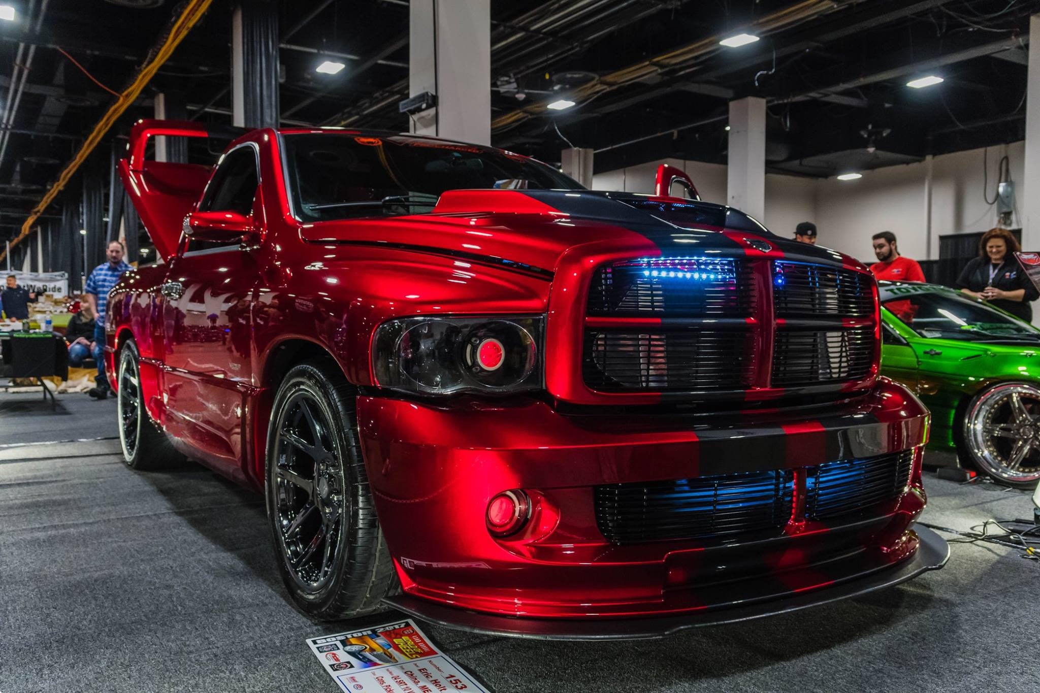

You can do what you want, it just takes money & time
The images below are sweet, i can almost taste it
This guy spent his money well :)
I would be afraid to drive it, it would be a trailer queen for sure
I have no idea why it reads Security
it is actually a customized
dodge/ram/2005/truck-that-turns-heads-red-ram-boasting-custom-lighting-and-aftermarket-mods
