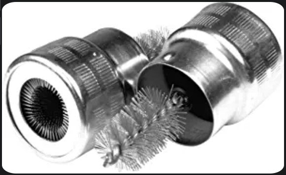

It sounds like you may have a fuel delivery issue but there's not much point in chasing anything start related without cleaning both battery posts and clamps first. The cleaner tool above is very cheap from Amazon or most auto parts stores.
I clean mine twice per year and in a warm area like Georgia, I'd clean at least once per year and coat both sides (post & clamp) with dielectric grease.
