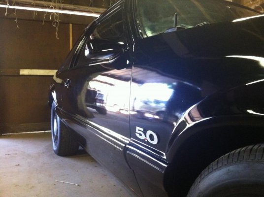

I know with my Charger and the Challenger would be the same way, it I think it was 16 or 17 they locked those down. It just now got to where you could get an unlocked pcm for them. I have been about 110 in the Ram. I’ve never hit a limiter in my Charger and I have gotten up to 115. I assume it’s 120, but dang it was a pulling hard. I agree with tire speed rating. I had a foxbody cop car in my early 20s and then again about 5 years later. Speedo read 160 and it would do all of that on tires that weren’t rated at that speed. The foxbody mustang was truly the last real muscle car IMO. I had one that I could daily drive. Throw a short belt on it and some slicks at 8psi and destroy everyone. I came within a half a second from qualifying for the old pinks all out back in 07. If you can find the Ennis Texas episode on pinks I am one of the opening cars and then I spun and lost out. The car was full weight with working A/C and a tremec. I used to be one heck of a racer. All it had was a built 347 and nos. Man I miss going down the track.
