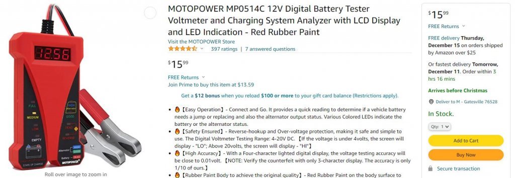

Check all cables and grounds and make sure tight and not corroded. On MY 19, I just changed out the battery about 2 weeks ago, put in a Duralast Platinum AGM battery (my battery was showing 11.9 Volts to 12.02 Volts resting (as in cold, not run like overnight)). Also, for giggles, I bought a lil battery tester. Everybody right concerning the modules and power pull. I can go outside right now, open door, pop hood, close door. Put that battery checker on battery and it will show 12.4 Volts and battery good. Leave hooked up and Watch the battery Voltage over the next ten minutes on cold status go slowly from 12.4 Volts to 12.6 Volts and finally reads battery full at 12.6 Volts. There are just that many modules running and pulling voltage, and it takes that long for some to turn off (go to sleep) and go up .2 Volts. Definitely get a battery. Also call where you are buying and see if they will put on a charger for you for a few hours before you buy. You never know how long a battery has been sitting on a shelf. Above is just my experience and IMHO. It is a good practice ne time you buy a battery, if possible have put on charger first, or definitely do yourself when you get home.
ADDED: Trick to pull battery cables takes longer like 5 minutes more like 30 minutes to a day. Most also say hold both cables together to pull voltage out of modules. Take that one at your own risk.
ALL ABOVE IMHO...
There a lot of more expensive testers out there that do a lot more. This is sufficient for a general test, not need anything fancy and you can even keep in glove box. Just what I use.
