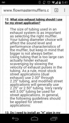

Straight from flow master, street applications for duals 2.0-2.25 and being a truck operating at lower rpm and having a relatively low power rating 2.0 is plenty. If you want to argue with me that's fine but its hard to argue with a company that has probably invested millions into r&d and been a leader in their industry for decades

True duals here @ 2.25 and its more than enough. A good sounding motor is not all about the mufflers its all about the motor and what's been done to it.
