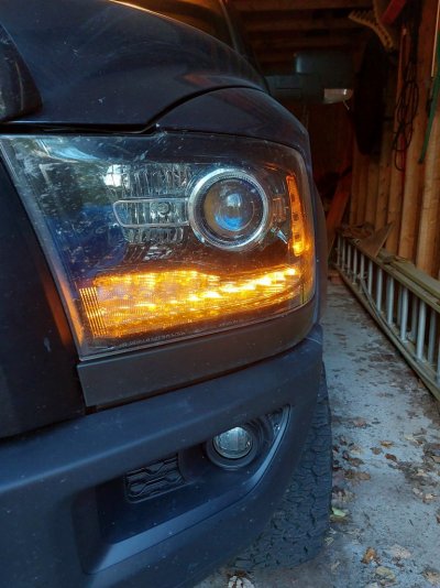

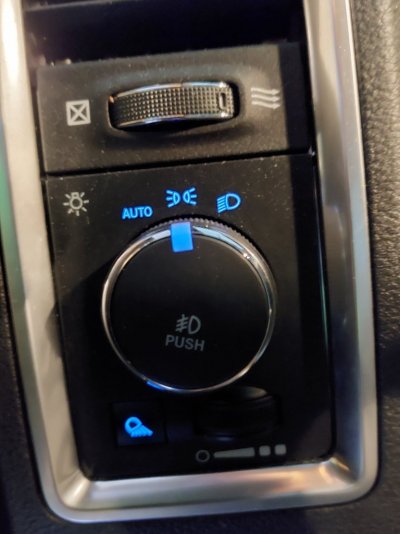

My truck is the Canadian version with no control of DTRLs but here's what I confirmed works on my truck;
I covered up the light sensor on the dashboard (to fake night-time) and moved the light selector knob 1 stop cw and then had no headlights illuminated only the front turn signals. (DTRLs)
Your truck is likely different but as brian42 said, you may have touchscreen settings to adjust.
