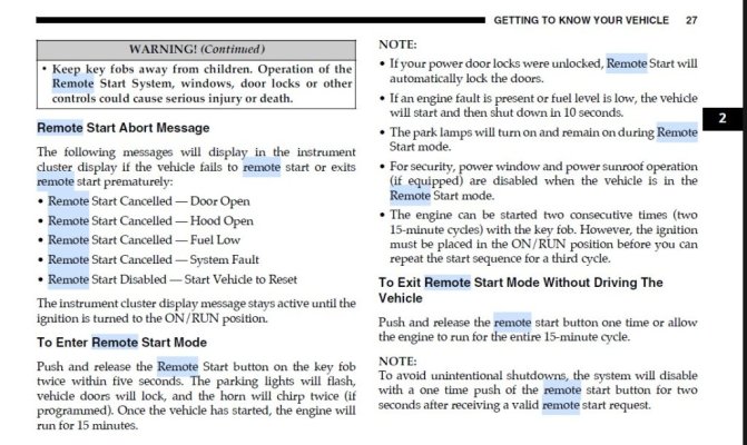

All I know I have never had my 15 ED or current truck, 19 5th Gen "relock" themselves after remote starting the vehicle and hit unlock. Of course, when U remote start, the vehicle cycles through various parameters, like insuring all doors secured-truck locks them, hood down, no MIL present, before remote system will even work. All I can relate is what my 5th Gen does and what my ED did, had a II Gen ED before this 5th Gen.
_____________________________________________________________________________________________________________________
In U connect Settings, there are various options and conditions you can set ref remote start. Way too many pages to copy/paste here. OP suggest you look in yer manual and/or download manual so you can review. Of course depends upon year of truck and sometimes Trim Levels on what options are available.
View attachment 558095View attachment 558096View attachment 558097
My truck never relocked itself if you remote started it and then hit the unlock button on the remote,but both of the wifes Challengers do and so does our 300,after a certain period of time they relock themselves.It's never caused me any issues,as i don't hit the unlock button till i'm walking up to them
