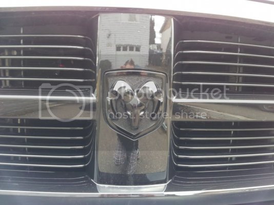

liquid mask is the way to go for shor,I did mine with shadow paint around the border and the ram head and an epoxy paint for the back ground,a light caot of the shadow clear to make the epoxy paint react and give it some texture let dry over nite and then about 10 coats of the clear and it has held up excellent. Here is some pics

Oh ya the shadow paint worked excellent for the emblems but not so good for the letters,it doesn't seem to hold up well on the sharp edges
that's a nice job, everyone's looks good. wish the 2nd gens had big ram heads to paint hah

Here is the front.
[/IMG]
