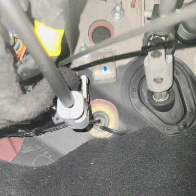

Trying to draw 30 amps off an existing in cab lead is not a good idea. Listen to the guys and put in a fused lead. There is no reason to run the ground all the way to the battery. You can see an easy spot to run a wire from the cab to the battery. It is the surround to the parking cable, just to the left from the steering shaft. In the picture, you can see the two wire extension for my 110 Volt in car heater. Make sure you use a round awl to punch the hole. 20230625_133546.png
