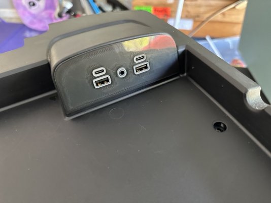

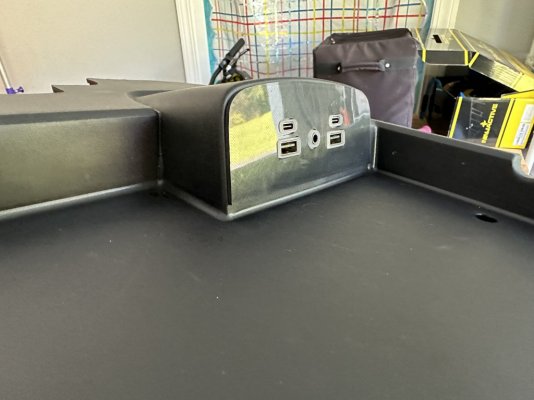

Correct. I had to new hub out after not getting AA to work and went back to original Hub, still didn't work. Had some family travel. Took some measurements of the hub case to try to create new 3D files to fit original opening so I don't have to modify/cut the original hole bigger.

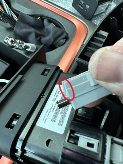

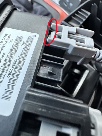

Just finished upgrading to a UAQ unit and decided to try the newer OEM media hub with USB-C too. I experienced the same issues others reported--power, but no device connection, and the charging stopping after several seconds. On the USB cable that connects to the back of the hub, there are two plastic wings that stick out and prevent it from being fully connected to the hub (they stop it from "clicking" in). I snipped those wings off and was able to fully plug the USB into the back of the media hub and Apple CarPlay started immediately for me. Not saying this is everyone's issue, but I highly recommend checking out if that USB cable is fully seated and locked into the hub, and if not, snip off just a bit of that plastic wing so it goes all the way in.
