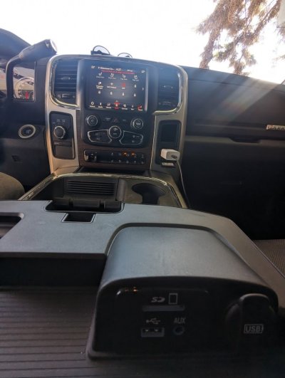

So I did a 5th gen console conversion. I have working all USBs and 110 outlets. Why does the 4th gen hub not work? I already have this style hub that came with my console. Is there something in the speed of the usb ports?
not sure.. I don't even know what happened other than that only 1 usb C and 1 usb A port works for AA.. I don't have 110..

Which usb is best to use in 2017 Ram 1500 with flip up console. I have one from a jeep compass I believe,but it doesn't come close to fitting and even though it works and I've had it for a year or so I'd like to swap for a better hub.
