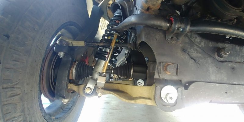

Here is my 4" Super Lift with Bill 6112s set to 0.8 as you can see the UCA is perfectly level. The only people that need those expensive UCAs are the ones that are to cheap to buy real lifts and get those garbage puck level kits.
You will need Suspension Maxx endlinks as the Super lift only includes garbage pot metal extensions.
