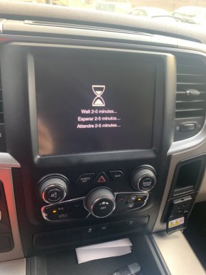

2013 Dodge Ram 1500 big horn (the big touchscreen radio without the nav)
I tried To do the uconnect update and failed and now it’s stuck on the hour glass saying “wait 2-5 min” and it 30 sec or so later switches to the insert usb and so on...at first I used a 64gb SanDisk usb (exfat format) then I read forums that said use fat32 so I go to buy another usb and got it to fat32 and still no luck...took it to the dealership and they said I need a new radio which cost $2,000+...any help or do I need a new radio? Also anybody knows if I can hard reset the radio so that I can get rid of that “wait 2-5 min”? Soft reset doesn’t work for me, thanks

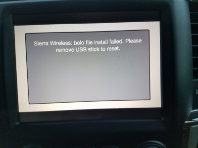

This is what showed once the update was completed btw

Sorry to say this seems to happen on some older units. The Sierra Wireless it is referring to is a controller board that is part of the radio. The install (usually) fails at that step because the controller board is bad, but sometimes it can be just because it is loose on the main board (it kinda sorta snaps in). But that is all internal to the radio, so not easily fixable.
BUT there is a place on the internet that will repair it, NavRepair I think it is. Far cheaper than a new radio, I think its $300.00 but you would obviously have to send them your radio.
THANKS! I will definitely give that a try, I tried everything I read in the forums and nothing, I will contact them tomorrow and hopefully get it fixed

Hi Alejandro,
We are sorry to hear about your frustrations. Please try to do these steps below:
Try holding down the hard round buttons for 20 or more seconds (should be the power button and the tuner button, underneath the screen) and this should reset your Uconnect.
