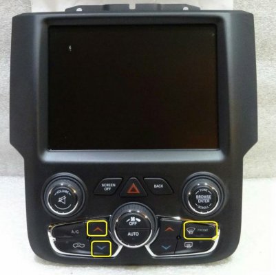

Yeah its def BS if you ask me...I was perfectly fine with how my radio was before! now the sirius xm channels look dumb as hell! And for example I listen to Opie and all the other shows on the Faction XL channel, well before it had the updated FACTION XL logo and now the radio has a ugly blue square that says THE OPIE AND ANTHONY channel...Anthony hasnt even been a thing for a couple years now so wth...
Can someone please walk me through how to Roll back update so I can get back to 16.13.13 or whatever it was, I do not like the 17.11.07 I have on my radio right now
I am not trying to be a jerk so please don't take this the wrong way, but why does it matter if it's the station logo or the album work on the radio? While driving you should be more focused on the road rather than paying attention to the logo or the artwork on the radio.
Either way I hope you get it figured out!
Here is how you get your serial number:
Check out this thread as well and if you need any radio help, MPgrimm2 is your guy!
